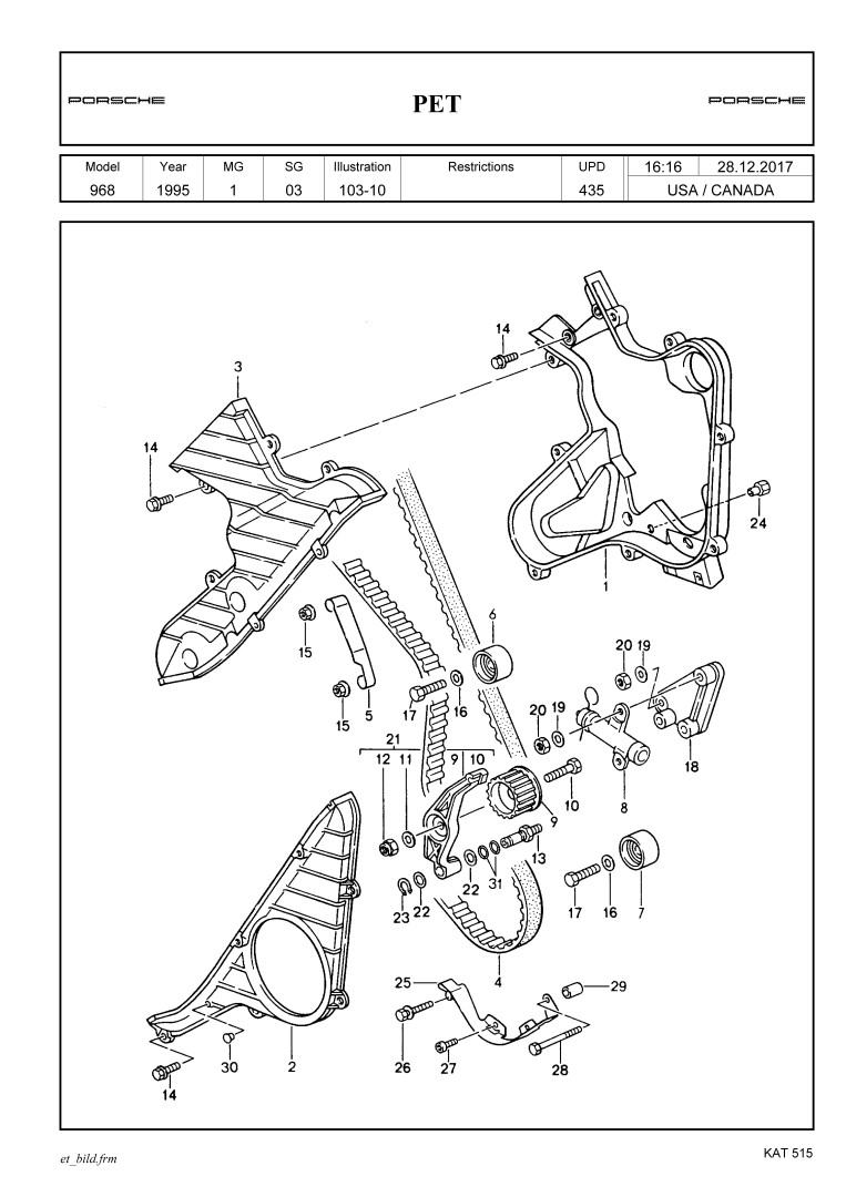

from the PET diagram
two O rings first, then one flat washer, then tensioner arm, then flat washer, then clip
PET does not show a different order for new or old pins,

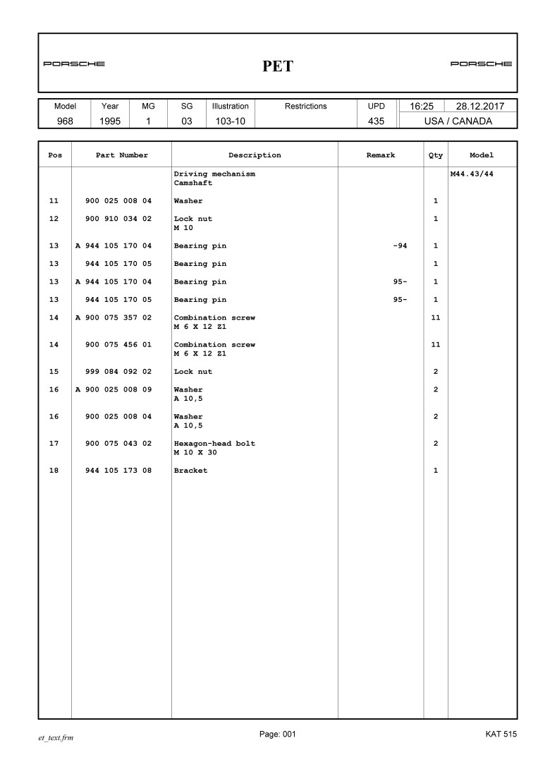

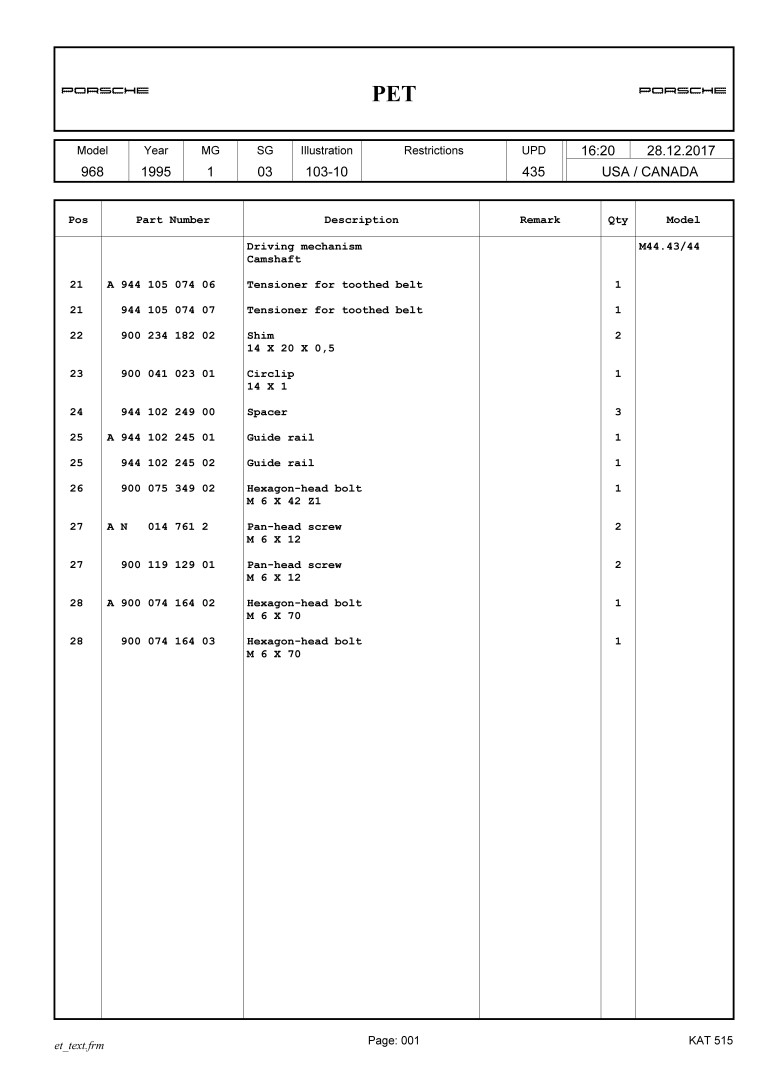

there are two arms shown in the PET
but no year attached
944 105 074 06
944 105 074 07
there is huge difference in price
06 $253.00
07 $398.00
that would suggest if you have the earlier shaft then you use the 06 tensioner, later shaft 07 tensioner

The "A" in front of the part number means stock to be used up
[Image: tensionertext.jpg]
[Image: Pin.jpg]

Waylander I was just looking up the same thing - but your PET is better than mine so I'm glad you posted first.
My (poor man's pdf PET - but just downloaded from porsche.com) lists the pin FOUR times but under two part numbers (diagram number 13), but only ONE version of the arm (the 06 but not the 07) (diagram number 21).
THAT'S confusing, and a little concerning since I depend on this document a lot.
