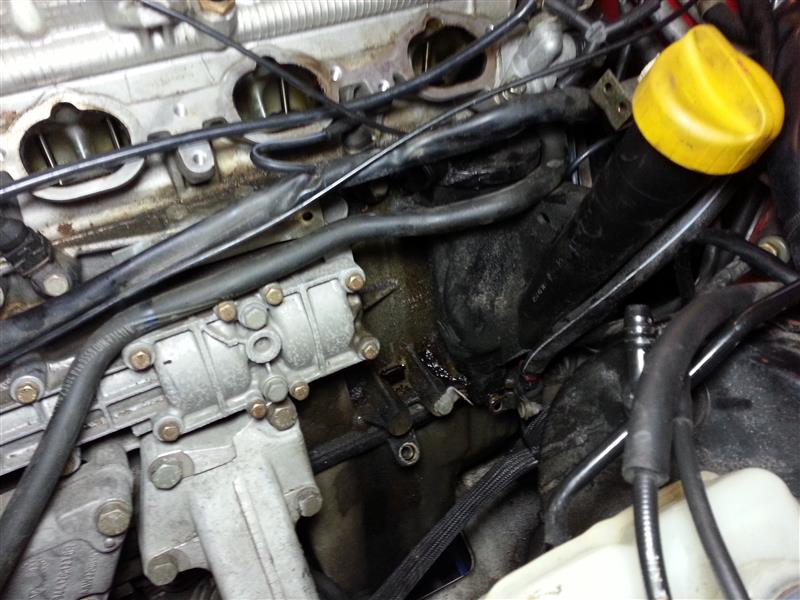

Got the intake manifold off this morning, along with the air oil separator.

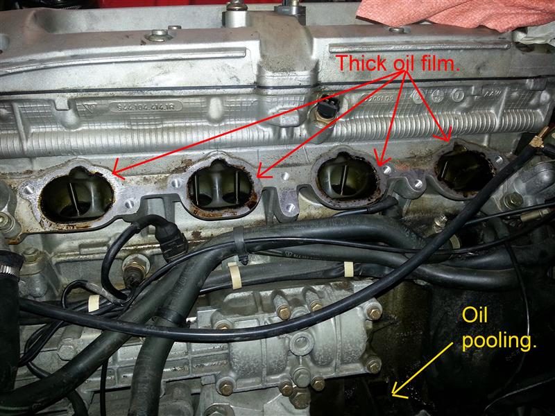

The intake bolts were not that tight, I was surprised how easily they came undone. There is a lot of oil gunk in the tips of the intake manifold and in the head itself, at least 1/16" thick sticking to the walls, and runny oil on the intake manifold gasket. There's also an oil flow down the side of the engine, pooling up under the air oil separator (or just ahead of it).
[Image: intake_oil.jpg]
This is a close-up of the oil on the side of the engine and pooling up under the intake manifold, near the air oil separator.
[Image: oil_film.jpg]

by the way, the amount of oil you have at the intake ports is not encouraging. that is a tell-tale sign of valve seal leakage. that would also explain your vacuum leak and boost loss.
did you do a leak-down before you pulled the intake off?
p.s. - i think the bolts are only 15 lb/ft (i always have to look it up), so they would pop loose pretty easily.
I was wondering where that oil would come from, it coats the whole inside of the intake manifold, although it's not visible through the throttle body. At 54,000 miles I wouldn't expect that much wear?

there are really only a couple of ways for the oil to get into the intake:
if the vacuum hose to the AOS is not the hard plastic line with rubber ends, too much vacuum gets in there and it will suck the oil right out of the crankcase and dump it into the intake.
if the valve seals are leaking, or guides are worn, it will allow oil to pass and get into the intake. no quick fix there. head removal required.
if the rings are not sealing, you will literally pump oil into the intake. this was my problem, which led me to a rebuild
