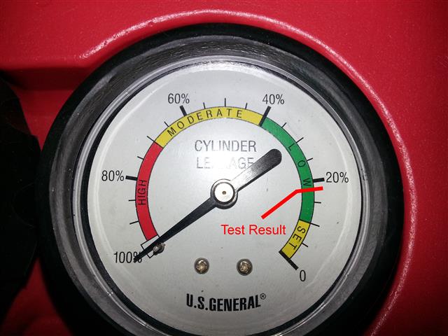

Leakdown test shows about 18% on all cylinders at 15 psi.
bummer - that's pretty big, but not catastrophic. is it at the rings or the valves?
From everything I've read that's OK, especially if it's consistent across all cylinders? Because it's a low pressure test, I wouldn't expect the valves to be pushed closed and the reading would be a little high anyway compared to the 100 psi testers. This is also a test with the engine cold, whereas some say it should be warmed up first - but I can't do that with the intake manifold off.
it's "ok" but not good. it should be below 10%. the real question is where the leak is. is it the valves or the rings? it's not as bad if it's the rings. if it's the valves, that's pretty significant.
I'll have to do it again and pay attention to where it's leaking - it was so far into the green zone I wasn't all that concerned. And, having been lead astray by gauges recently, I don't know how much stock I'd really put into this thing, either.

yeah - that will be the real determination of condition. if it's mostly rings when cold, then don't even worry about it. if it's valves though, then you need to start looking at things. i am concerned because of the oil in the intake. you may have some leaky guides or seals. again, the numbers aren't so bad that it won't run decently, but you may not get all of your boost, and may still have a vacuum leak.
tell me a little about this leak down test you're doing. What I am familiar with for leak down is a test done on every piston aircraft engine at least once per year. With that leakdown test you set 80psi going in and look at the psi the cylinder will hold. On a real good cylinder that pressure will be in the low to mid 70psi range. Normally the test is done with the engine warmed up.
I have such a tester and will do an "airplane" leakdown test on my pretty well broken in fresh engine rebuild at the first opportunity. To do this you need someone to hold the crank with a wrench. The 80psi in the cylinder gives it a great tendency to rotate!
This test is done at <acronym title='top dead center'>TDC</acronym> to prevent piston movement and to ensure the valves are closed, and I think the tester maxes out at 15 PSI on its output side, even though its operating pressure is between 7-100 PSI on the input side. The instructions don't call for the engine to be at operating temperature, but admittedly they're in "very good Chenglish" so I don't expect them to be complete. 15 PSI isn't enough to force the valves closed, so they are only closed based on their own spring strength. I'll try to re-run the test tomorrow at a higher input PSI just to see what changes - today's test was with 40 PSI on the input side of the gauges.
The test I am familiar with is also done at <acronym title='top dead center'>TDC</acronym> with valves closed. However, even a fraction of a degree off of <acronym title='top dead center'>TDC</acronym> with 80 psi on the top of the cylinder (that's 1005 pounds pushing down on that piston top) is going to make that crank want to spin. You do need someone on a wrench with big breaker bar to stop that rotation potential. I have no idea why 80psi was chosen as the standard for testing leakdown on airplane engines, but it has been that for a looooong time.
yeah - with every tester i have ever used, you have to use a flywheel lock and a lot more pressure than 15. i use 100psi to keep things easy. you have to do it cylinder by cylinder, listening for the leak in various places to determine where it is.
