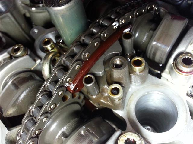

Just thought I'd post a picture of the VarioCam pads while I have the top open. I don't know how brittle they might be, but there's so little wear on the pads I can't even really feel it with a fingernail or scraper. I don't know what worn cams or sprockets would look like, but those are smooth too. I don't plan to do anything major this time, as I'm troubleshooting a vacuum leak and don't want to get in to a serious "while you're in there". But I'm happy all the long bolts broke loose with no breaking OFF.
[Image: variocam_pads.jpg]
all looks good from here, but admittedly it's a limited view
Yeah, at your mileage, if the car has gotten regular oil changes, I'd be surprised if you'd be seeing a lot of wear of these parts. Nice to confirm, though.
+1 on the Copper RTV. Pads may look ok but they do get brittle. Mine had very light score lines on rebuild #1 but when they were removed you could see little chips missing from the plastic. That was at about 128,000 K (80,000 old school).

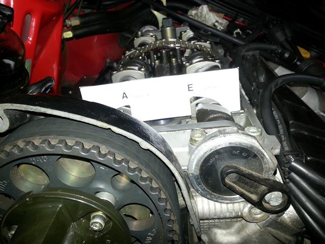

Just to verify for everyone, the cam gauge in the popularly-available PDF version of the manual does not fit, it is the wrong scale (much too small).
[Image: cam_gauge.jpg]
it's possible your pdf is not scaled correctly. unfortunately they don't give a reference dimension for rescaling
Yes, hence my request(s) for the actual width, but nobody is biting.
i have a hard copy of the manual. tomorrow i'll pull it down and measure it.
Many thanks. Could you measure both the horizontal and vertical dimensions of the rectangle? That would give me the correct aspect ratio, and I could scale it accurately with that from any size.
Again a vague recollection, I seem to recall my mechanic having tape in the middle of the gauge. I think he cut it and inserted an extender slice of paper.

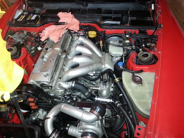

Re-pressurized tonight and confirmed that the camshaft cover is tight. More hissing from down under the intake manifold, in the area around the oil filler neck - I could feel air moving with my fingers!
So, off comes everything again, this time on the intake side. Is it possible to get that throttle body off without making a coolant mess?
[Image: intake_work.jpg]
I crimp the coolant hoses with a small needle nose visegrips wrapped in tape. Hey I also noticed that the center port is plugged on your throttle body. Should have a hose connected from the throttle body to the air oil separator.
Kwikt, thanks for the tip - I'll have to pick up some more vice grips but that should work.
The plug is part of the D1R Supercharger installation - that port gets plugged, and as you might be able to see from the yellow/brass coupler the hose is still there but it is extended forward and (not shown in the picture) it enters the intake at the metal elbow (just before the supercharger head unit).
My guess is that's so it will keep suction on that line at all times and not put boost into it.

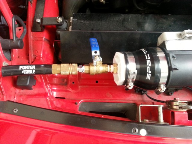

You may have said it somewhere in this thread, so my apologies if I'm asking you to repeat something you're already said, but how exactly are you pressurizing your system when you're checking for vacuum leaks?
For testing with vacuum, I'm using a MityVac kit and plugging it into various points in the system, then using the gauge on the MityVac to monitor how long it holds.
For testing with pressure, I'm removing the K&N and using a silicone adapter/reducer to a PVC cap with a ball valve threaded into the end of it, then an air hose quick-disconnect fitting. I plug a Boost/Vacuum gauge into the system to monitor PSI, usually near the fuel pressure regulator as it's easy to get to.
Here's an older picture of it. I've since removed the rubber gasket in the intake snorkel hole.
[Image: air_rig.jpg]
