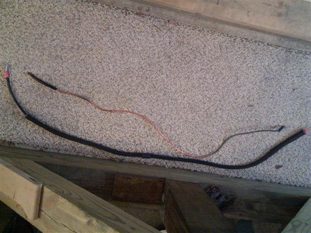

Here is a picture of the main alterator-to-starter cable, with the outer sheath removed. I show it next to the new Robby cable for comparison. Note there is NO insulation left on it, and a good 18 inches of it is green from getting wet.

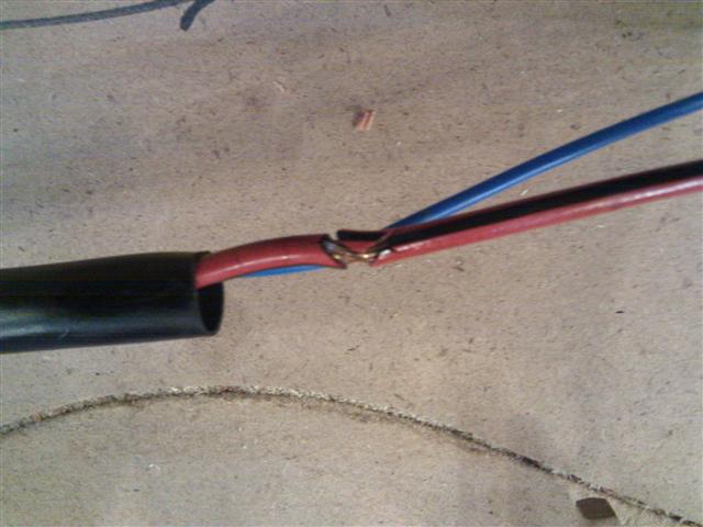

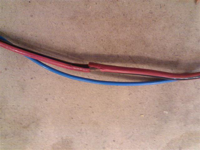

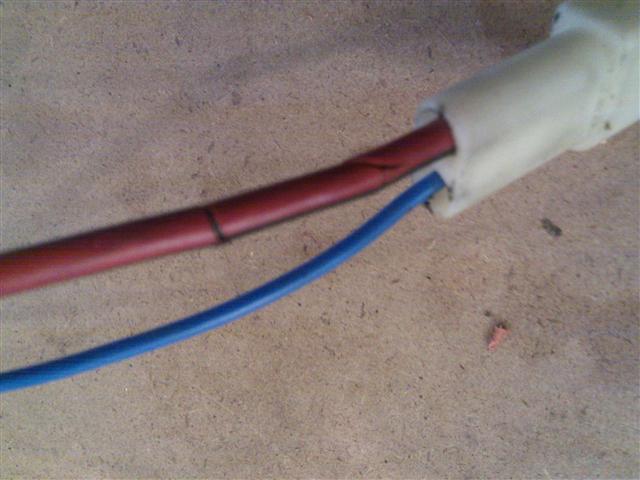

And here are photos of the red cable, broken already in several places. Now I have to go to Napa to try to find some replacement wire, and hope I can salvage that round connector on the end, because this thing is cracked all the way to the tip.

I now have to re-create the red wire as much of the insulation is cracked off *it*. That means procuring suitable wire (easy if I can identify the properties of said wire), affixing a ring to one end (easy), and then disassembling the electrical connector at the other end (hard), removing the bullet connector (very hard) and putting it all back together again.
