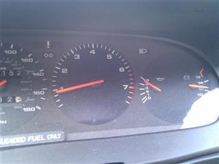

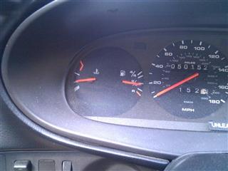

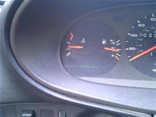

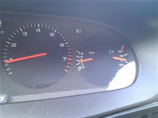

I noticed that a small change in temperature makes for a sizable change in oil pressure. I warmed the car up the other day and took pictures of the guages, all while at idle.
With the engine still warming up, and the temperature gauge at the 8 o'clock mark, the oil pressure was still near 5.

A few minutes later, with the temperature gauge at the 9 o'clock mark, the oil pressure was about 2.5.

This probably has something to do with the oil temperature itself, I would imagine it takes a short while for the oil, including all of that in the sump, to heat up?
