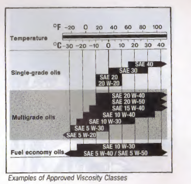

What does your owners manual say about viscosity in you locations temp range
I run my car on 20W50 as thats what the manual says, and I live in the UK
[Image: Grades.png]
I have to check don't know off hand but I don't think it is 20 50
Before you do anything, use a mechanical gauge to validate your information.
