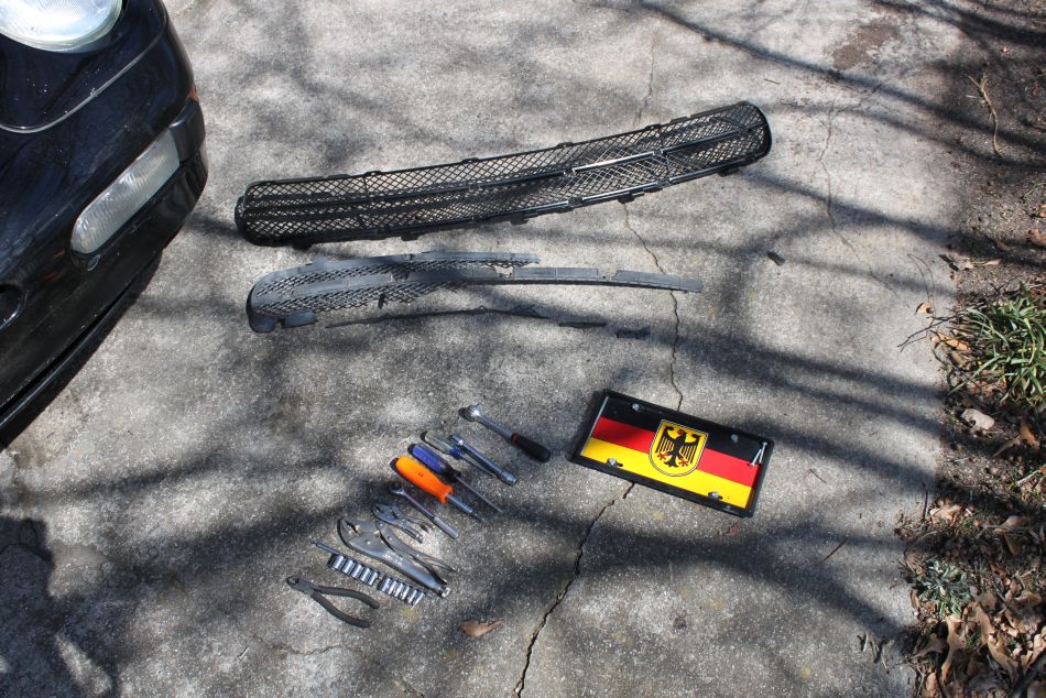

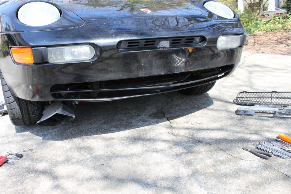

[quote name='kzem1' timestamp='1362363209' post='139448']
Did you replace the grille without taking off the bumper?
Yes - wasn't that bad with one side up on a jack stand. I got the oil cooler out of the way by removing the four 10mm bolts. I do need to order a new airduct as mine was in bad shape. Getting it out of the way helped.

[quote name='lbpesq' timestamp='1362369646' post='139460']
By "airduct" do you mean the little curved snorkel that feeds the air to the airbox? If so, you might want to do a search of the site for "airbox mod". Perhaps the single simplest least expensive surprisingly effective mod you can do to a 968. The mod completly does away with the snorkel.
No - this is a plastic shroud that routes air into the condenser and radiator - part number 944 575 141 00.
