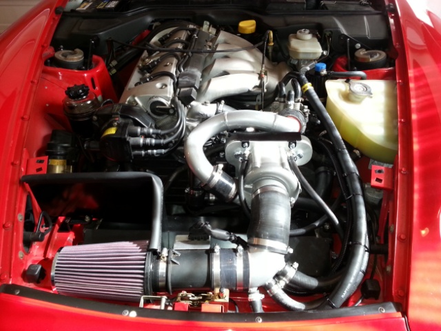

Stage 1, 2 and 3 completed today... Holy cow the trials and tribulations! Details to follow in succeeding posts.
If everything had gone right, I could have finished a day earlier, but gravity and chance were ganging up on me most of the time.
Supercharger, Stage 1 at this point, running.

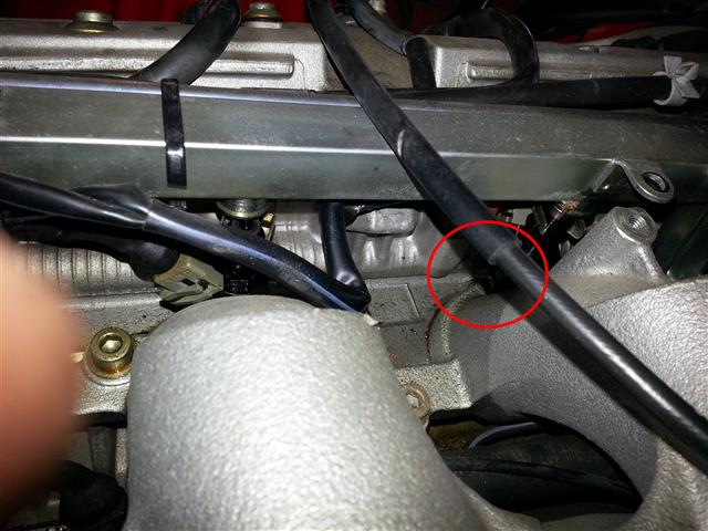

When taking off the original injectors, one of the square clips sprang off and disappeared. It was either order a new one or go on the "hunt of a lifetime" for that thing. After 30 minutes of looking above and below, I saw the edge of something square buried below the intake manifold, and miraculously a magnet fished out the clip! Thank gosh! You might be able to see a hint of it in this photo.

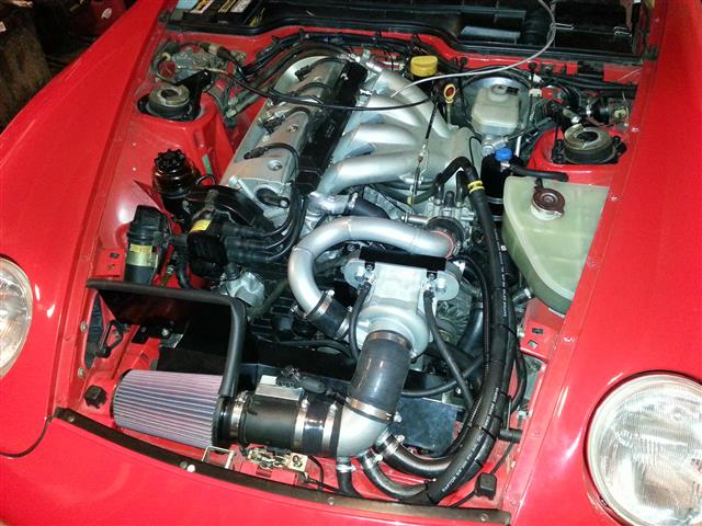

Finally, at last, here's Stage 3 after a 5-mile test drive.
Now, I need to drive 60 more miles gently, and then I can do the fuel pressure test, take off the fuel pressure gauge and button it up!
[Image: stage_3.jpg]

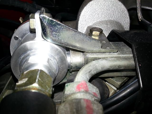

Here's the fuel pressure regulator close-up, to show it's all snug.
[Image: fuel_pressure_regulator.jpg]
Here it is, all buttoned up top and bottom and test driven for 65 miles and then some! The latest Design 1 Racing Supercharger, Stage 3!
[Image: stage_3_supercharger.jpg]
