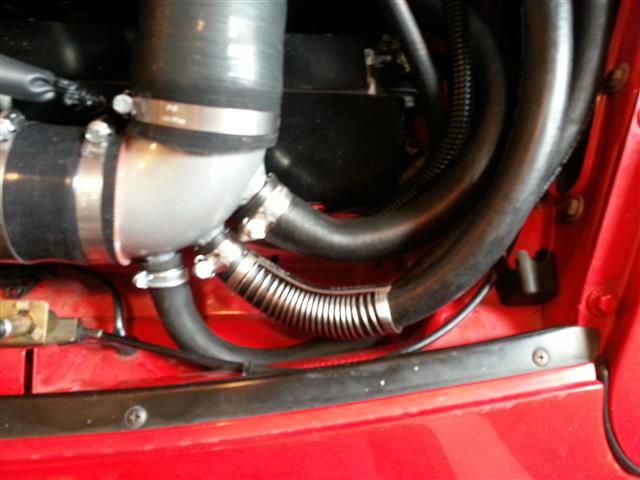

I had a large (and worsening) stumble at 2K RPMs when cold, so I went out today to fiddle with the hoses and test vacuum. As I re-arranged things, the hose for the ICV came loose at the barb fitting. Apparently the old hose is expanded and the barb fitting does not make a great seal. So hose clamps went on both ends of that just to be safe. A test drive showed some improvement.

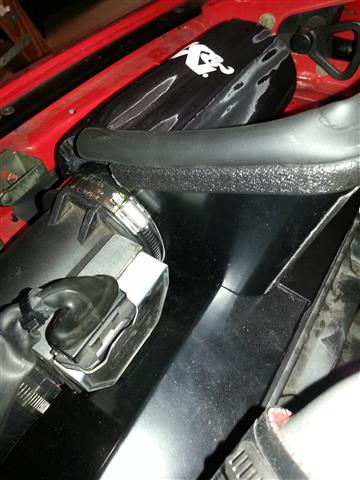

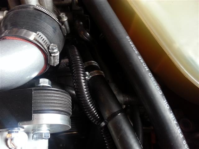

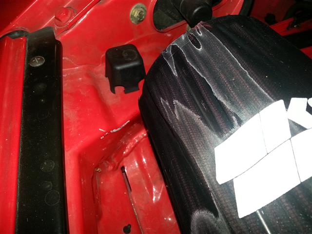

I also re-arranged the hoses to avoid kinks, and had to do over an hour of modification at the front of the engine bay for several reasons. First, I have never been happy with the bend in the hoses, and second, the K&N never fit right and rubbed on the inside of the engine bay, destroying a brand new K&N sock. @!#$
I pushed the big silicone elbow further onto the supercharger and that created about 1/2" more room. Likewise, there was no avoiding trimming about 3/4" off the front rounded part of the intake shield, as that thing has never fit right and simply would not allow the intake hose to run straight. But given the variability of the height of the radiator (it is on rubber mounts, after all) and the multiple angles required in that part, it's not surprising that each car's idiosyncrasies might add up and require a little bit of tweaking there. A little bit of tin snipping and some filing to round the edges and it fits quite nicely now, with no real loss of function. Thank goodness, because that thing has caused me some real swearing.
Lastly, I went to two auto stores and tried to find hose springs for all of the hoses that tend to kink. They are 5/8" (Raptor), 3/4" (Gates) and 1" (Gates) hoses. Please note that the 5/8" Gates hose spring will *not* fit on the Raptor hose, as the hose is a little too big. I did get the spring on the ICV hose and took a test drive and everything seemed OK, so I'll leave it on there and see how it goes. I'm picking up a 1" hose spring this afternoon as they had none in stock but are getting one from the warehouse.
