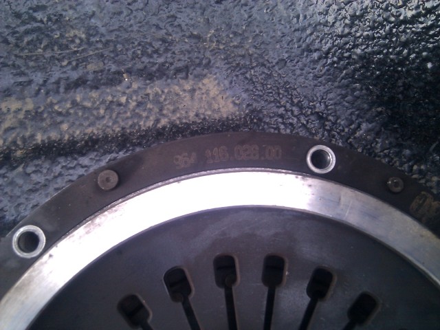

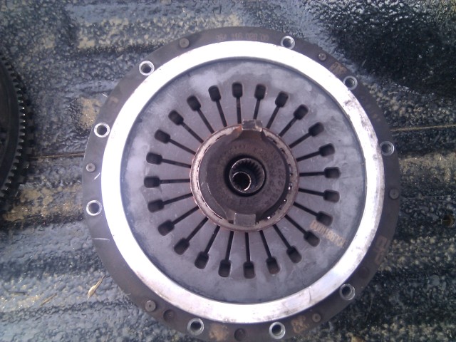

Do I need to worry about these differences? Here are pictures of the removed clutch and flywheel - the pressure plate is "alternate" but correct per the PET, and "heavy duty" per AutoAtlanta, part # 964.116.028.00.

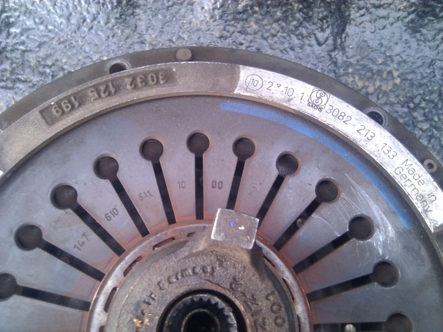

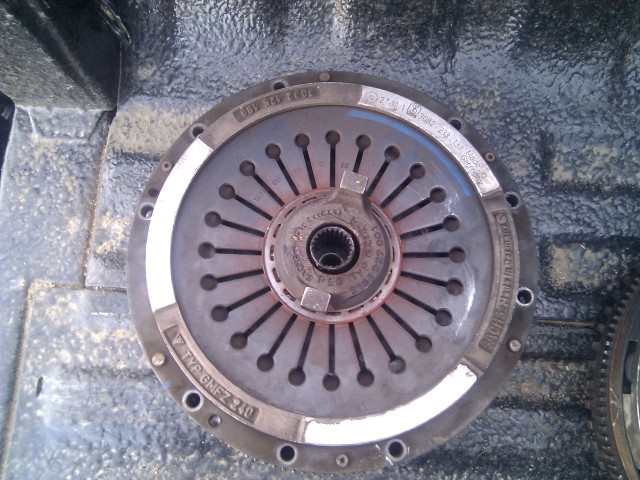

The replacement is a Sachs unit with a blue stripe, and at least according to the workshop manual, the blue stripe (on the original part) is for the 911 Carrera 2/4, and green is for the 968. Should I be concerned?

yes, you should be concerned, if you are seeking original fitment and pressure.
the blue stripe is stiffer. this will provide more clamping force, but will dramatically change your pedal feel. it will also subject the firewall to more stress.
i'll dig up the pressure specs today.
the original part number is 964.116.027.90 and is somewhere around 2400lbs
the alternative replacement part number 964.116.027.01 is NLA
the alternative replacement part number 964.116.028.00 is NLA
964.116.028.90 is for the 964 C2/C4 (pretty sure it's 2600lbs)
964.116.028.91 is for the 3.3 turbo (3100-3300lbs)
964.116.028.53 is for the 3.6 turbo (pretty sure it's 3700lbs)
while the pressure rating of the C2/C4 plate isn't much higher than ours, the geometry of the springs is different, and combined with the higher rating, results in a "ramp" feel in the pedal.

I wonder if the blue stripe means something different on the Sachs unit,... According to a thread on that other forum, this Sachs unit is about 2,500 pounds and is also a factory standard unit (and I did buy it from a 968)... There is also a reference to this part number with a green stripe on it instead of blue - damn the Internet.

it really depends on what you can tolerate in pedal feel. there are a LOT of cars with the plate you are talking about. many people just deal with it. i found it hard to tell where you were in the stroke, because of the "ramp" effect.
the firewall brace will mitigate the added stress on the firewall issue, if you can deal with the other problems of the blue stripe plate
that being said, i have the 3200 plate in my car, and i love it. others find it too stiff. it does have a nice progressive engagement like the OEM plate though. however, i would not want to use my plate if it were a car that had to be in traffic, as it is just too hard on the leg. i have gotten cramps when sitting in traffic on way too many occasions.
Flash is correct. The correct replacement clutch has a green stripe. I ordered mine from RS Barn, and it does in fact have a green stripe. Interestingly, the one I pulled out of my car, which I thought was original, had a blue stripe, so it must have been replaced at one time. I'm looking forward to experiencing the "original" feel to the clutch, especially after replacing the fork needle bearings and fork shaft, in addition to the clutch slave cylinder and braided high pressure line a few years ago.
as a reference, my plate is sachs# 3082.213.132
green is the softest. blue is a bit stiffer and has different feel. no mark is stiffer still (mine). red is stupid stiff.
Quote: Interestingly, the one I pulled out of my car, which I thought was original, had a blue stripe, so it must have been replaced at one time.
This replacement is a pull from a low-mileage car, and is also a blue stripe...
yeah- it's pretty common. there were a few years between vendors substituting the part and us discovering the difference.
