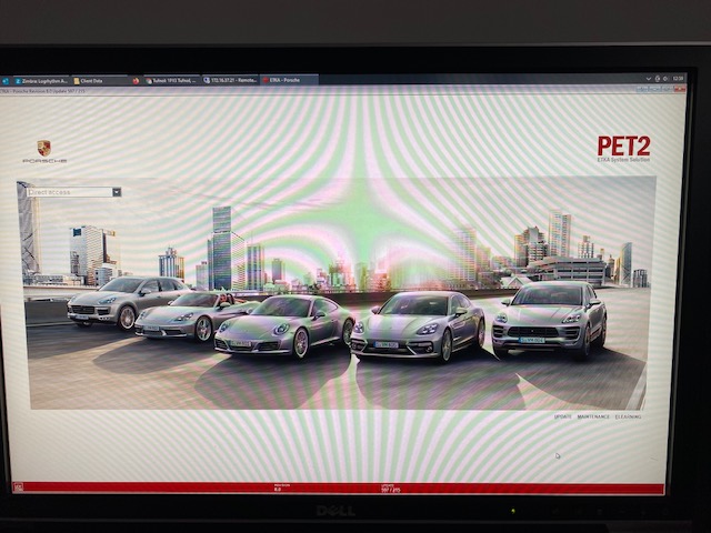

Not using a catalogue, I have a fully functional Porsche PET2 system thats updated every week with both parts updates and prices,
Sometimes Im more upto date than my local Porsche dealership parts department, it the same software they use

Waylander, how did you get your hands on that?
Even bigger question how can we?

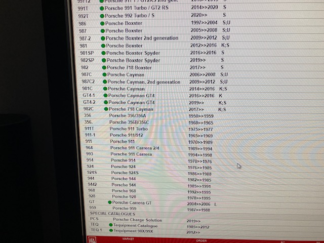

I got the base system from bit torrent, then with a lot of hacking the windows 10 kernel space, managed to get around the software lock, then discovered where to get the updates from
Took me about 2 months to get it working
[Image: IMG_0885.jpg]
[Image: IMG_0886.jpg]
[Image: IMG_0888.jpg]

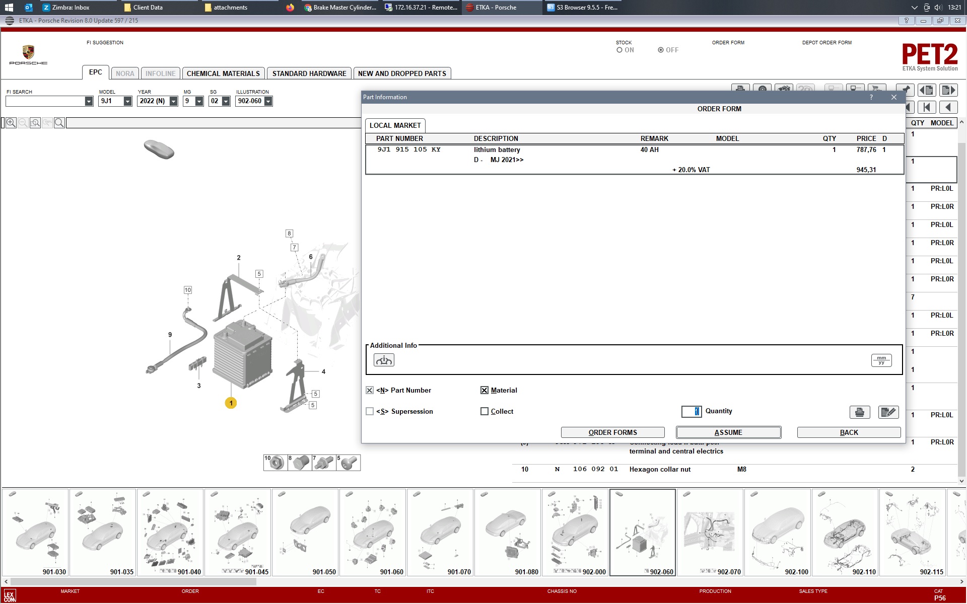

It has the classic spares and the seats as well as all telequipment stuff, some of the prices of bits would make you go grey, Fast charger for the Taycan Turbo S $15,000 plus installation

Taycan Systems Backup Battery 40AH, almost $1000, can you imagine having one of these at 30 years old, never happen
