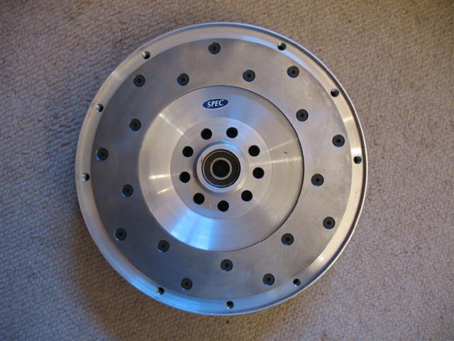

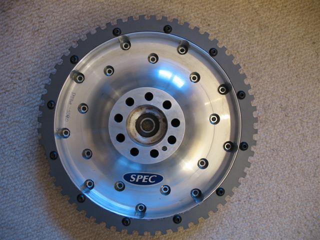

Flash,
Currently, I have a Spec FW with a Sachs clutch kit, and, obviously, I have the noise and rattle problem in the transmission, especially in 1st, 2nd and 3rd gear.
I don't know if the Spec FW is the same as the Fidanza one, but they look like the same.
Anyway I hope that your clutch disk will work too... <img src="/forum/images/smilies/968/dry.gif" class="smilie" alt="" />

it might - won't really know without putting it together, but from the photos, i think it will
looked at it again - there might be a couple of problems - have to take some measurements to know for sure - tough to see from the shots
the outside diameter of the pilot bearing flange may be too large and interfere with the back of the disk
the "dish" of the front face is the big question - how far down the bolt surface is relative to the friction surface will determine whether or not the bolt heads hit anything

It should be something like 0.2 inch (5-6 mm)... if I remember... <img src="/forum/images/smilies/968/mellow.gif" class="smilie" alt="" />
Edit: I misunderstood the message of flash, sorry.
