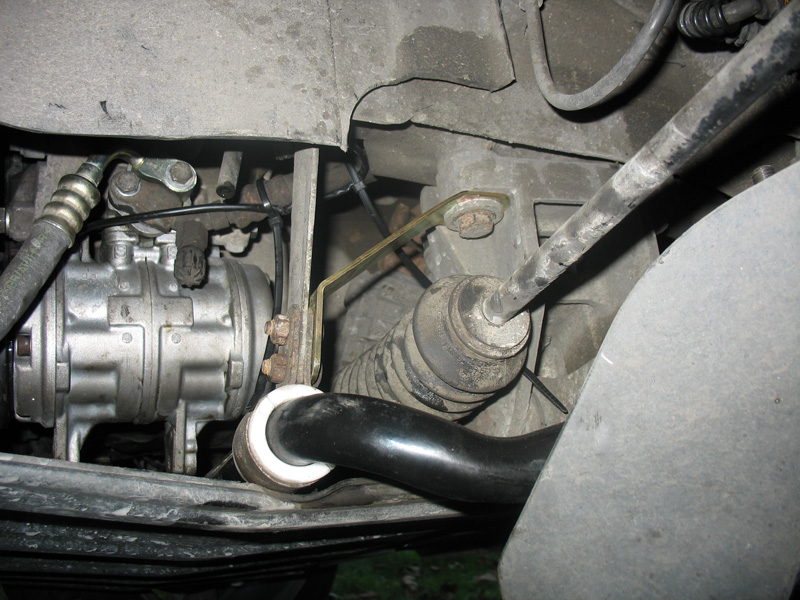

[quote name='flash' post='46850' date='Feb 4 2008, 03:06 PM']as long as you are not going bigger than an M030 bar, one brace (kla or tarret), solid mounts at the body, and rubber at the control arm will be a good setup[/quote]
I have also that setup on my car:
M030 sway bar
KLA braces
Delrin solid bushings at the center
OEM rubber bushings at the control arms
[Image: IMG_3245.JPG]
Thanks to your comments and some research at this forum, the front sway bar doesn't have any big secrets for me anymore.
Philippe, your photo of the bracket support is very significant. Perhaps in this summer we can organise a meeting between us. Brussels and Zemst is only 20 km aside. Strange thing internet is , 2 persons in Belgium starting to know somrthing of eachother by means of an American forum. Our electronic communication travels for some 10.000 kms while in fact, we are located only 20 km aside ...
