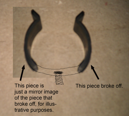

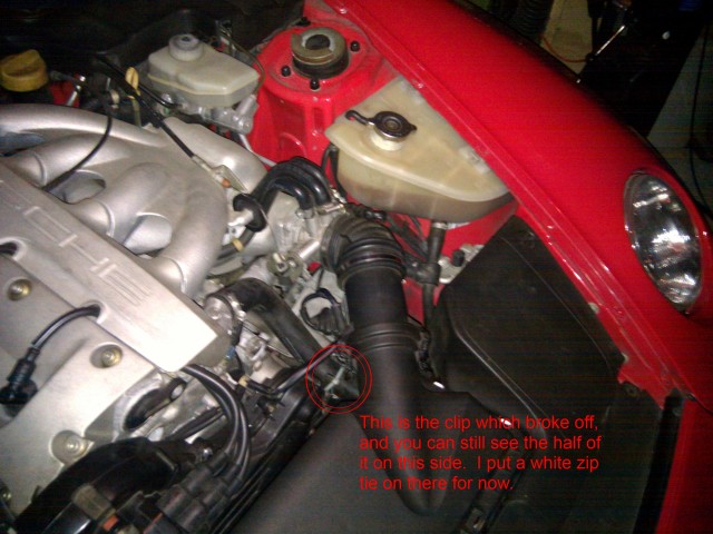

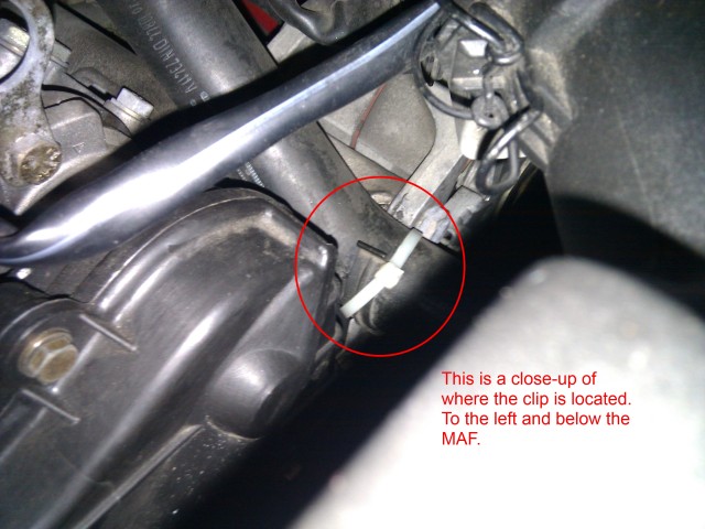

Here are some pictures of the the engine bay for context, a closeup of where the part is located, and a closeup (and lame drawing) of the part that broke off. Still no luck with the PET or online searches.

Thanks for looking, unfortunately clips 33, 34, and 36 in that diagram are the reverse of what I need, eg. their mounting pin is split across the open tips of the clip, and I need the one where the mount pin is on the closed side of the C shape. I had Sunset send me a photo of those ones yesterday to confirm. I did order one just for grins, as I'd rather have a Porsche part on there than a zip tie, but it won't be the right part so the search continues. <img src="/forum/images/smilies/968/sad.png" class="smilie" alt="" />

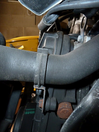

Here's a good photo of the part, taken by jakerade.
[Image: hose_clip.jpg]
