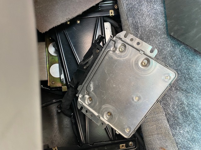

Quote:I have spent 3 hours today repairing a water damaged Motronic ECU, it had one pin completely missing, bit of a pain as it was in row 3, right at the bottoms.
all done put it in the car just on the lead not bolted in, works fine, save a fellow 968 owner $1600

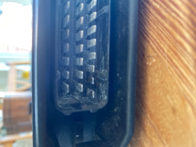

Ok as I can't edit the original post,
the missing pin
[Image: IMG_0033.jpg]

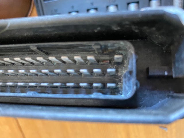

So after a lot of fiddling and a bit of surgery, pin replaced
[Image: IMG_0032A.jpg]
Cleaned the rest of the pins up, sealed it with clear nail varnish, then hung it in the car to test
[Image: IMG_0053.jpg]
Perfect working order now

Well done, as said that would have been fiddly. But the missing pin ... not trapped in the socket? And if not, what was its purpose?
The car had been parked outside and leaves had blocked the two drains in the space between the screen and engine, water had been soaking the ecu for a while
The owner was driving and the car just stopped and would not run again, the AA transported it to a indie, and when they unplugged the ECU the pin snapped off in the harness plug,
The indie sourced a second hand plug and replaced that cut and shut wire for wire, as the plug was fully rotted out, the ECU is $1800 exchange, so I fixed it for him, car is now running again
