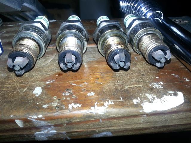

OK, I put new plugs in it. Got the ones recommended in the thread about supercharged cars and plugs. The old ones were "tri-tip" Bosch and were in the 7 range. A few drops of oil in the center two holes, but not much, and I suspect that's from pressurizing the system to check for vacuum leaks.
I tested for vacuum at the fuel pressure regulator and it was 16-17, sweeping up and down between the two every few seconds. Car was cold and at idle. Leaving the hose disconnected did not effect idle. With all hoses connected, the severe stumble was still there, so more testing is necessary.

[Image: bosch_plugs.jpg]
#79
yikes! those can cause detonation in a hurry. they don't cool off. on forced induction that can be a real problem. good thing you got them out of there.
#80
Yeah, based on that other thread, I figured they needed to go!
