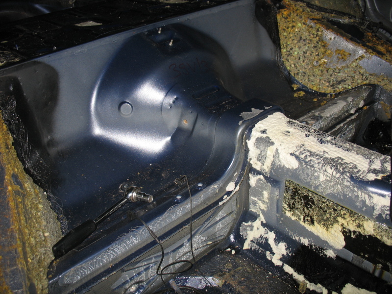

The best rear seat delete... <img src="/forum/images/smilies/968/laugh.gif" class="smilie" alt="" />
[Image: IMG_3429.JPG]
Porsche 968 CS M030 Iris Blue Pearl
you mean like this?
[quote name='flash' post='48279' date='Feb 27 2008, 03:17 PM']you mean like this?
[Image: attachment.php?thumbnail=4599][/quote]
Thats cool, I think this is the way I will go with my car. Got plans? <img src="/forum/images/smilies/968/blink.gif" class="smilie" alt="" />

sort of - i introduced this over a year ago, but got no real interest - if there is enough interest, i can get a mold made, and run these off
You might do well if you include the 944 guys?
Thats looks really nice.
1993 Guards Red 968 coupe with 6 speed limited slip
thanks - works very well - took a few versions to get the shape right so it minimized reflections - very happy with it now - gives me a nice back massage

Flash, I just removed the rear cubbie on my cab and wondered what your solution for dealing with the metal tabs was?
Cheers. Joel
cut the weld - bend them down - smack them down - pull carpet over them
