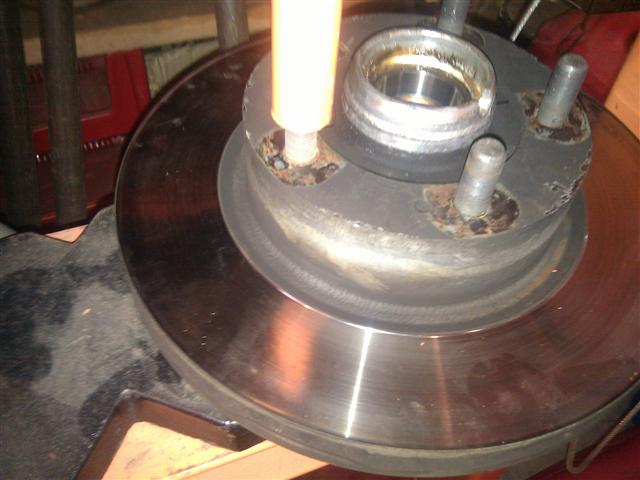

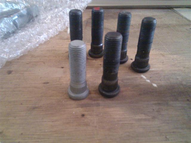

As I wait for the studs to arrive (supposedly next week), I'm just posting a couple of pics for future reference, one of the studs being pressed out (yes, the Harbor Freight shop press is really cheap but man is it handy for stuff like this), and one showing how short the H&R studs are compared to the stock ones.
[Image: pressing_studs.jpg]
[Image: short_studs.jpg]

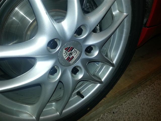

And they're finally ON! After several MONTHS! And yes, I should have shortened the studs after all - they're too close for comfort, so I'll be taking everything *back apart* tomorrow for the spit and polish and "better safe than sorry" bit. They're wider than the stock wheels, that's for sure. Grippy and quiet, too.
[Image: s_ii_wheels_on.jpg]
