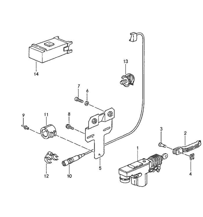

The locking mechanism has three main components. The first is the microswitch that detects if the key's been turned (10 in the subsequent diagram). That sends the signal to the central locking to unlock the other door. The second is the mechanical link between the lock cylinder mechanism and the mechanical lock on the door. The third is the actuator (1 in the subsequent diagram) that locks/unlocks the doors via a command from the central locking mechanism.

[Image: 804-06.gif]
Problem 2 & 3 are most certainly that the link (the part labeled 2) has worked come loose on the driver's side door. It's an easy fix, popping the link back on to the appropriate ball, but requires taking off the inner door bits.
Problem 1, if I had to guess, would be the driver's side microswitch. The mechanical link is obviously working, since you can unlock the door. The actuator isn't working, based on problems 2 & 3.
In what state are the rubber gaskets around the door handle? And the seal at the bottom of the window? Water could be causing a short in the microswitch on the door handle, or it could be accumulating in the bottom of the door and causing a short in the connector.
Good luck and let us know what you find!
