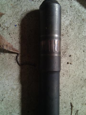

There are some curious furrows on the release bearing fork cross pin (951-116-133-00), where on one half of the shaft the needle bearings wore themselves into the metal. Looks like I'll be replacing that anyway along with new bearings.

Here's a picture of the scoring on the throwout cross shaft, just on one half of the circumference. A new one has been ordered.
[Image: cross_shaft_scoring.jpg]

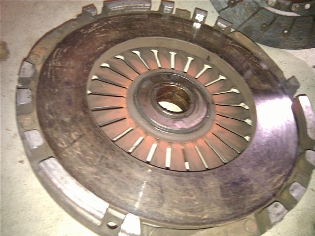

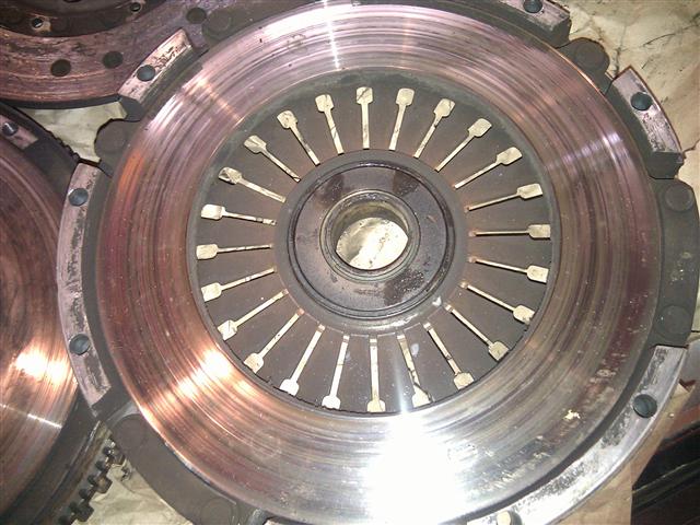

And here is a pic of the old, and new pressure plate(s). You can see the waviness in the old one, whereas the new one is very smooth.
[Image: old_pp.jpg]
[Image: new_pp.jpg]

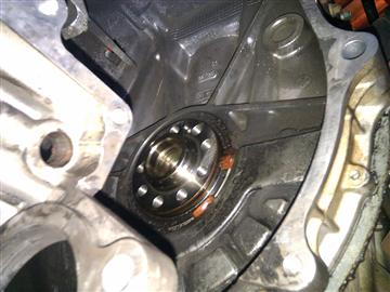

At some point in the past 20 years, an enterprising chipmunk somehow got an acorn behind the flywheel - bully! The mainseal looks dry, and I'm not inclined to mess with it if it's OK, I've heard horror stories about getting that thing out and replaced without scoring the surfaces...
Recommendations - do it anyway you sissy, or let sleeping seals lie?
[Image: acorn_flywheel.jpg]

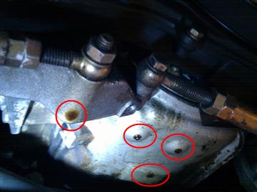

My hesitation is that I had zero oil leaks until I took it into the shop and had them replace the seals, just because they were in there doing the belts and rollers. Now I have little drips everywhere and the smell of burning oil for the first five miles when I drive the car (while stopped).
[Image: oil_drips.jpg]

I know many may not agree with this, but I would leave the rear seal alone.
