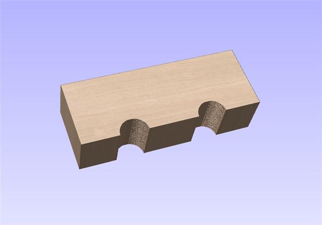

Re: cam blocks. If you have access to tools that can shape sizeable chunks of aluminum, they shouldn't be hard to make. I had a guy at work make a set for me out of maple, and I attached some thick metal strips to the tops of the blocks to help disctibute the force. For the clamps, I had another co-worker weld a pair of threaded rods to a pair of spark plugs, from which I removed everything but the threads.
Unfortunately, the guy who made the blocks cut them in the "wrong" direction relative to the grain, and they both cracked about 3/4 of the way through the job. But they held long enough to help absorb the stress of the valve springs. Seeing the solid maple blocks crack definitely gave me some pause - there really is a significant amount of force applied to the cams. If this were a straight six, I think the blocks would be indespensible. But obviously, since so many have R & R'd their cams without the blocks, I would rate them slightly on the side of a nice-to-have, if you've very, very careful and extremely patient. I removed my cams without the blocks, and, being the coward that I am, it must have taken me over an hour to complete the job, turning each nut about 1/64th of a turn each time!
#47
Ah, so you're the "maple guy" I was referring to in an earlier post. Wood's strength is greatly dependent on its grain orientation - sorry to hear your friend fabbed them up incorrectly.
With aluminum it would take me some time, but given the correct dimensions, I could crank these out all day.
[Image: maple_cam_block.jpg]
#48
Maple is incredibly hard to come by here. Best I could do is pine and I suspect that's not strong enough. I'll find someone that sells block aluminum and go from there. Do you still have the dimensions that you used for yours Cloud?

Yep, that's it. If you have the capability to machine aluminum stock, it shouldn't be hard to make. For the hold-down rods that screw into the spark plug holes, I bought a couple of cheap spark plugs, knocked off all the ceramic insulator and the electrode running through it, leaving just the thread, and had a co-worker with a welder weld them to a pair of threaded rods.
#58
Maybe I am stubborn, but for the life of me I cannot see the difference between pulling the cams down with these two bridges or by the bearing caps themselves. By difference I mean easier or less stressful on the cams or less prone to damage the cams. I just don't see it. But hey, if you like making or buying tools (and I do plenty of both), go for it.
