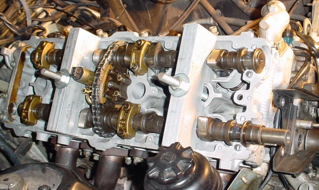

Is this the magical tool? It doesn't look that hard to make...
[Image: camshaft_bridge.png]

[quote name='RS Barn' timestamp='1341332933' post='128877']
It is nice to have the factory tools...
Checking out possibilities, it seems 928 Specialists list the blocks for $180. Then you still need the tensioning bolts (which seem to be only part of a $550 kit). In lieu of buying these, does anyone have a set that they'd be willing to loan for a few months? Or maybe provide the basic measurements so I can get one made up?
