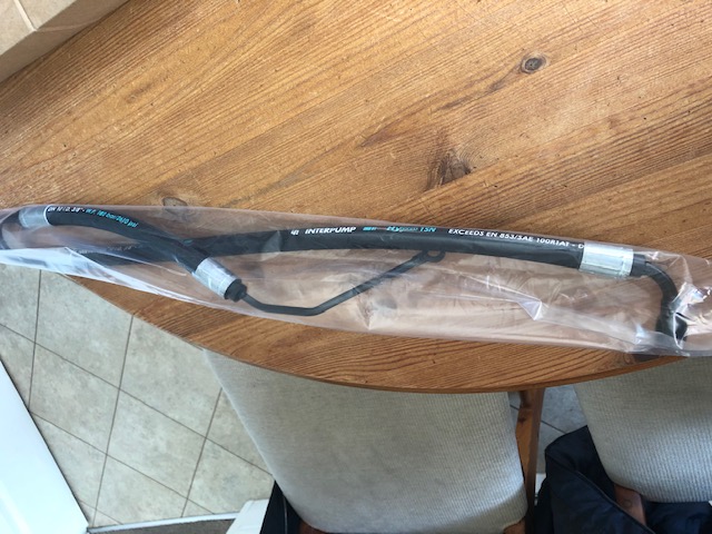

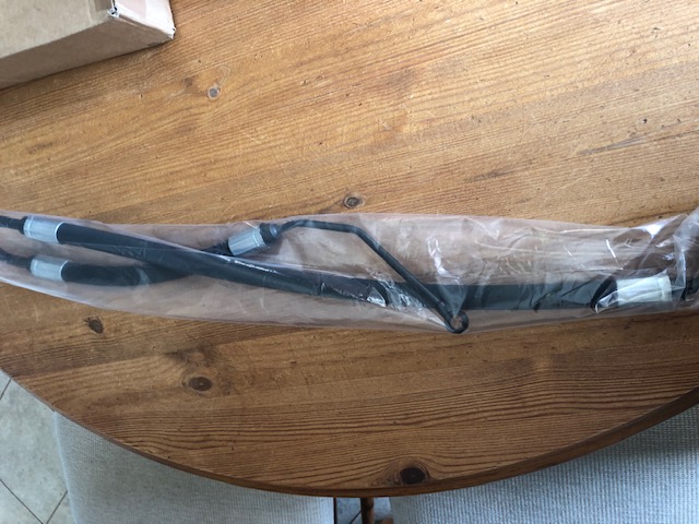

anyway I found a company here called Power Steering Hoses, got a brand new one that was made for a 944 for £84 so that’s about $105
so I’m happy, just waiting for delivery
New line arrived, had to cut all the protective stuff off the old one and superglue it on to the new one, but there it is in the bag
so this is $100 worth

this is about twice the size of a LHD one as it goes across the car and back, I have the old one that i will take to my local store Pirtek, I'm sure they will want a small ransom.
