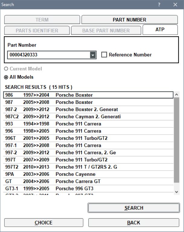

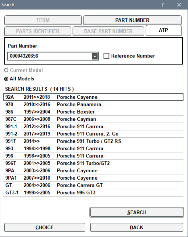

ok so the part number quoted was superceeded in 2006 from 000 043 203 33 to 000 043 206 56,
the first part number is for these cars,
[Image: pas-fluid1%20%28Medium%29.png]
the superseeded
is for these
[Image: pas-fluid2%20%28Medium%29.png]
as far as I know none of these have the Vane type pump that we have in 924 / 944 / 968, so i think you are correct wrong fluid
