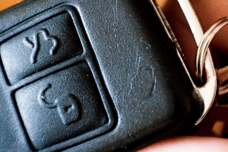

I went ahead and purchase the product and here are pix of the finish key FOB. It's actually a great product and easy to install. It allows to lock unlock all doors and trunk with the parking lights blinking for confirmation. I think its a worthwhile upgrade and an easy mod.

Very simple mod and you can find the instruction here on the site on the install of the keyless system. It took me less than an hour to complete the whole project. The final cost was $89.95 for the system including shipping, and $3.95 per key cut at your local hardware store ( Osh, home depot, etc..). The system comes with a template for the key mod. I used a regular hack saw and file to make the mod. It took about 7 min per key.

If you look at the 2nd thumbnail, it shows the key that was cut by the Osh and the template that you need to copy. You will need a dremmel or hacksaw to trim the head of the key and duplicate the template. A file is helpful to finish it off if you are using a hacksaw

mine showed up today... got one key cut... took quite a while with the dremel(would have gone much faster if I had the correct cutting wheel)... next step is the wiring

holding up fine... one mark where I gouged it with something... don't remember what it was, but I recall doing it.
[Image: keyfob1.jpg]
[Image: keyfob2.jpg]
