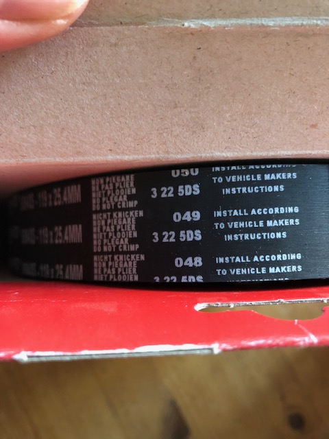

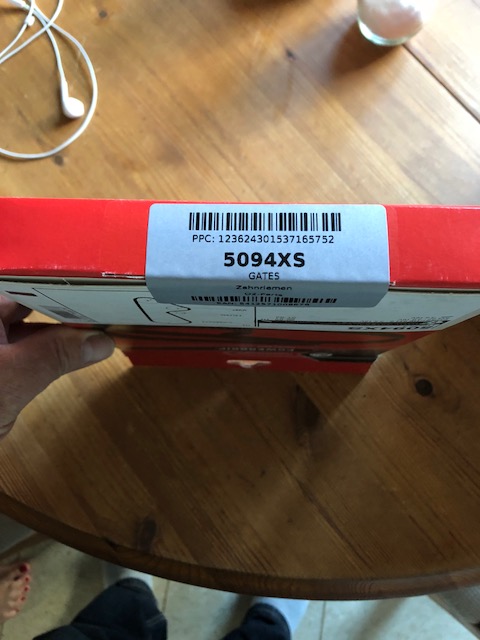

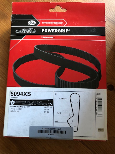

Just arrived,
A Gates belt from AutoDoc in Germany, and guess what, its going back again
[Image: IMG_0324.jpg]
[Image: IMG_0326.jpg]
[Image: IMG_0327.jpg]
I make that the 3rd Day of the 22nd week, possibly 1995, 2005, 2015, so even at the best date its nearly 4 years old

#98
LOL
Keep looking...
Sorry, couldnt resist
Happy friday everyone
:0)
BTW, my bet is 2015 is the most recent / only batch of these.
