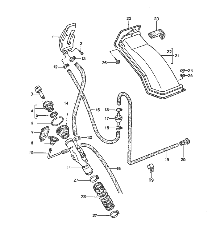

Fellow 968 forum members, I am at my wit's end.
I have pulled all the trunk pieces out to expose the lines on my 92 cab, and I can't figure out how to get the input pipe (where the gas cap threads on) out of the fender.
I pressurized the tank to about 2 psi, and it leaked out in under a minute. There is no obvious leak anywhere I can see, and no dampness or staining either. The car has a very strong gas smell, regardless of the amount in the tank, and I fear I will soon be driving the most stylish of Molotov Cocktails.
Anyone out there had any luck pulling these fittings out? There has to be a trick, but thus far I have not been able to figure it out. I am not opposed to swapping out parts to make this problem go away, but I hate replacing parts at random. The threads seem to all be in agreement that these cars have gas fume issues, but they don't seem to agree on the most likely causes.
So, where should I look first?

[quote name='MCL968' timestamp='1384822210' post='152481']
I re-read your question, and I have to say, it was difficult getting the filler pipe out of the gas cap area. Here is the outline for the cab:
[Image: 201-05.gif]
The first thing I did was to remove the piece of metal (semi-circle ring) at the gas cap filler, it's like a c-clip, needs to be pulled out (item 6). Then once that is out, I believe you can pull out the neck sleeve, item 7.
I might or might not had to remove the hose clamps and break the seal at the gas tank first, item 27. I know when I put it back in, I put the neck sleeve back in, then inserted the filler hose, item 11, into the sleeve at the top, then wrested in back over the tank neck. Then tightened the clamps down. Make sure it goes down around the gas tank neck 100%, the first time I did it, I only seated it about 60% of the way, then had the gas spill out when I filled it to test it!
Good luck, I have not seen the cab apart, if you want to post some pictures, I'm sure we could figure it out.
