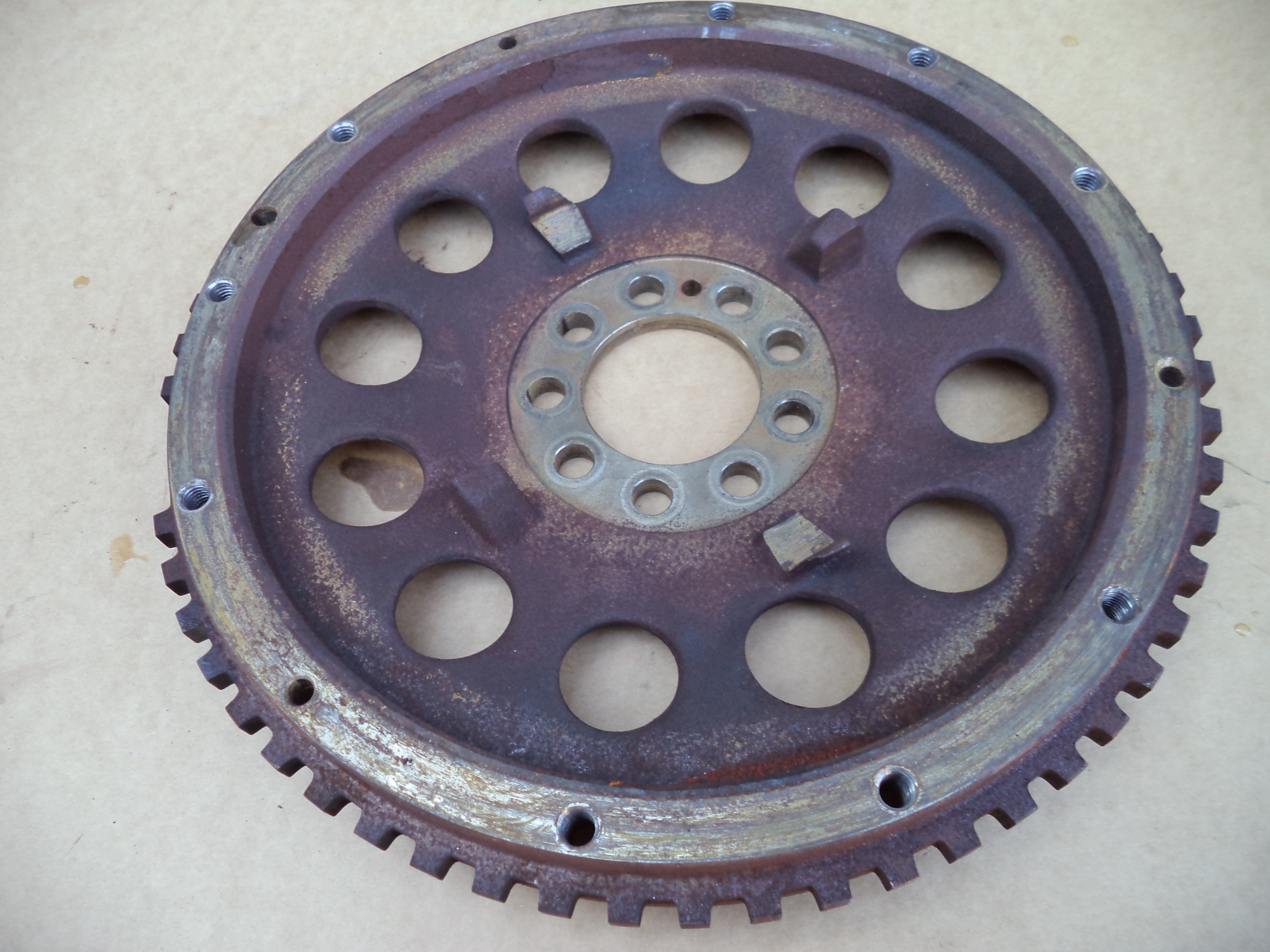

Also I believe I read somewhere that the two big lugs on the centre of the drive plate hook on the inside of the flywheel to provide drive even if the rubber in plate is completely destroyed, they would not touch with all the rubber inplace.
Found this picture, you can see the lugs that the drive damper should hook on if it fails completely, bet it makes a bit of noise

<p style="font-size:12px;font-family:'Helvetica Neue';">Now that you point it out with a photo of the flywheel, it’s painfully obvious where my rattle was coming from.  You’re correct, the damper would catch on the flywheel as you’ve described, creating a fail-safe.  Perhaps the fail-safe is fairly durable, given the condition of the damper I removed.  I’ve been chasing that intermittent rattle for a while, which would suggest mine has seen some use.  Thanks for the explanation.  Big Grin
#33
Yes, that is the fail safe to get you home. Two of your four catch lugs have been machined off by the wings on your old damper.
