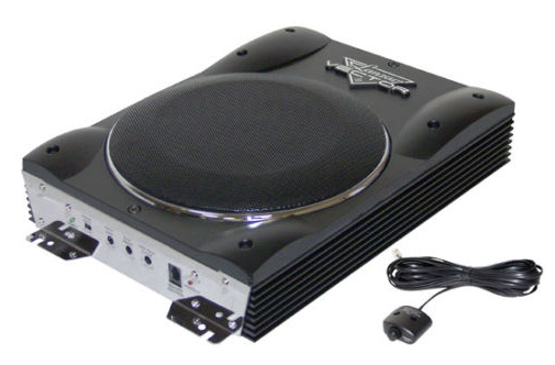

I bolted one of these right to the wood that covers the DME in the passenger footwell, then re-attached the rug over it. That position was nice and close to the battery for the dedicated power line. I mounted the little gain adjustment knob out of sight on the left wall of the glovebox, but it puts out so much bass I can't turn it all the way up so I just leave it at about half-mast.
[Image: lanzar_vector_subwoofer.png]
