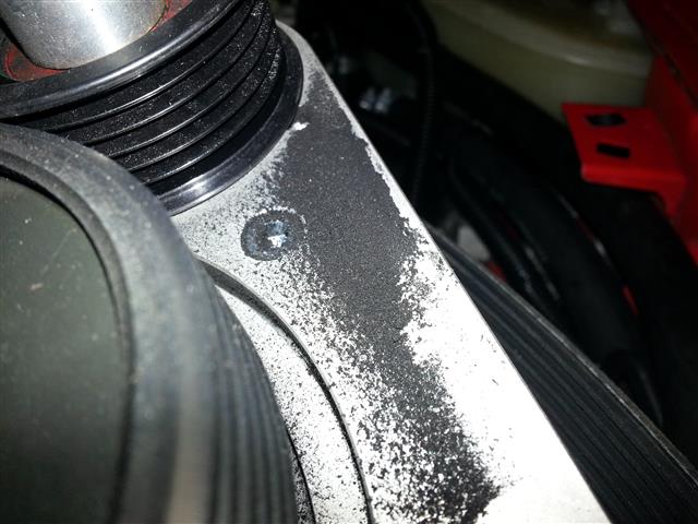

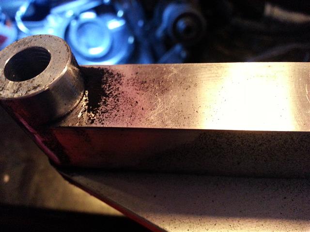

Just curious how much "dust" or "chuff" other people's SC belts are generating. I have had what I would estimate to be "low" tension on my SC belt since installation, and here are two pictures of the dust that builds up on the unit, after about 2,000 miles of operation.

yeah - something is tearing up the belt more than it should. i would look closely at belt alignment, and to see that you used the correct lower idler pulley spacer (the one down by the alternator), and that your belt is in the center 6 grooves of the SC. then check to make sure the belt is not hitting the belt guard (adjust as necessary to clear)
Belt is definitely in the center of the SC. I did check and re-check during installation that I had the proper spacer - because wouldn't you know it I put the wrong one in the first time and had to back that bolt out again. !#$@
I am definitely still hitting the upper belt guard, because the tension is so low. I keep taking it up a tiny bit at a time, and then a week later it's "tinging" again.
I just did a two day DE, It was spotless before, I'll look tonight to see how much dust I see and let you know.
I definitely don't get that much dust. I get the odd bit of black rubber spittle scattered around the area after a week or 2.
Checked mine last night, about 1400 miles on a new belt and two DE's, really no sitgn of much dust, in fact to only belt dust I could find in on the underside of the hood, and minor at that.
Yeah, I often have a little tiny black dust line there as well.
