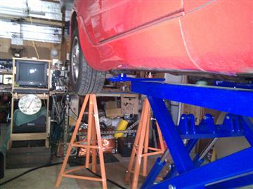

There is just enough room under there to be comfortable working overhead from your knees, or on a little roller stool. My garage height (with the gantry crane overhead) would not allow me much more lift than this anyway, and the real reason I bought it is that it's portable so I can take it to my next house.
I can't tell if there is deflection in the back lift arm or not, (it looks like it) under the passenger rear, but I give it the woolly eyeball every time I walk by, and there are no less than four 2-Ton jackstands under the car too, just in case something goes wonky with this thing.
[Image: car_on_lift_2.jpg]
I notice that the car tends to be a bit "nose down" due to the lift points in the rear being lower than the very front of the frame rails in the front. I did not want to use the "safe points" in the front of the car due to them being collapsible on the 944 I had, and there is no good information on using them for the 968.

Looks good but I'm curious. With the lift in place and those 4 towering jack stands securing everything where does the mechanic get to stand and work?
The photo makes it look tighter than it is. Which reminds me of a girlfr,... Never mind.
I'm working on the clutch so I have the car backwards on the lift, one end if which is pretty open between the lift arms. I can get right between the two jack stands and have plenty of room to work overhead. Not standing, mind you, but way, way more room than if the car were on short jacks and I was on a creeper.
I have had a pretty easy time of it so far, knock on wood, but if I were on a creeper this would be the job from hell.
no problems dropping the exhaust?
If you lived in a seismic place, where the earth has an alarming tendency to shake.. would you trust that lift + the jack stands to keep your car in the air?
@flash - nope, no problems removing the exhaust. I did have to lower the lift slightly, leaving the car supported by the jack stands in the front, to get off the rearmost steel pan because it has those high "ears" on it, but only by a couple of inches.
@mbardeen - I can't say about that because I've never lived in a seismic zone, so I don't know how much the earth moves. I can't say as I'd trust anything to hold my car up if the earth started shaking, because any support would be susceptible to a given harmonic, would it not?

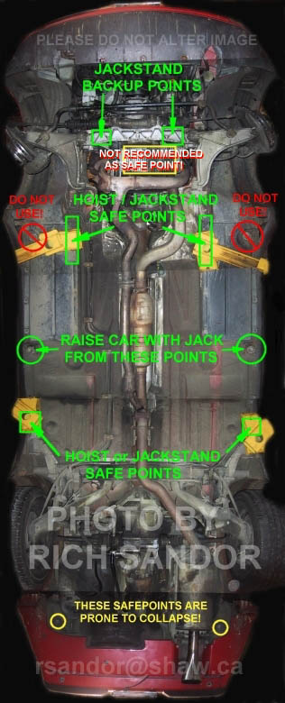

I am still trying to figure out, what do you use as the lifting points? If you use the safepoints, where would you place jackstands and where do you find jackstands that tall?
I used the safety/lift points in the rear, and I used the front-most points on the frame rails in the front. Then I placed the jack stands under points that will hold up the car, but that I probably would not use to lift it except in an emergency, for instance under the transmission in the rear, and under the control arms in the front. I think I got those terms right. Some sources say the front safe points are OK on the 968, but I know they weren't on my 944S and I just haven't dared to try them.
I got the jack stands at Harbor Freight. They had them all in stock, and they were $59 each.
I kind of used this picture as a guide:
[Image: 944_968_lift_points.jpg]
Thanks tama....useful information!
