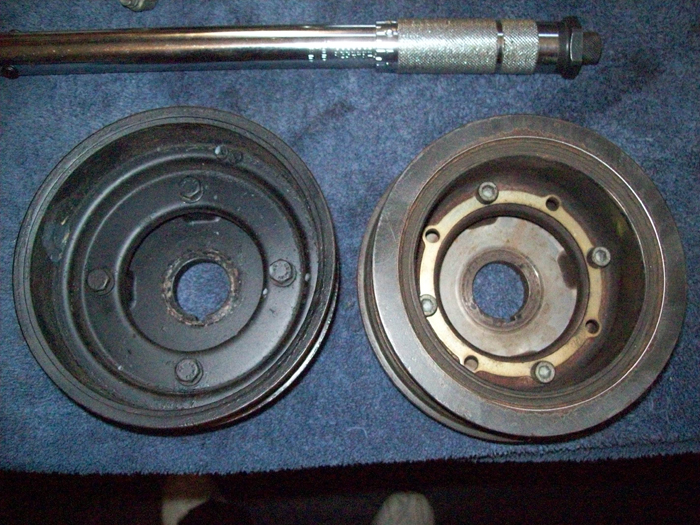

The S2 harmonic balancer has a rubber coupling between the inner and outer shell. 951 on left below and S2 on right. The 8 holes will bolt straight to your 968 balance shaft pulley. Maybe you got a non S2 944 balance shaft pulley, which only has 4 holes?
[Image: s2hb.jpg]

Ok. Call it the crank pulley. My S2 crank pulley only has 4 drilled and tapped holes. This aspect of the S2 pulley which I have (others may be different ) is a different design than the 968 crank pulley. Really I am not making this up. I may be able to post pictures later, but trust me. They are different b
Well stupid me. Caveat emptor. And all that. Apparently I didn't have a true S2 damped pulley all along and didn't know it. Bought it from a gentleman on the forum who I see hasn't posted in a year. It was different than my 968 so I assumed it was the right thing.

Got it figured out. I did get the harmonic balanced S2 pulley. But it was attached to an S2 balance shaft belt pulley. That vintage only has 4 attachment points even though the AC/alternator/SC pulley that came with it has 8 holes. I didn't know any better and put the full S2 assembly on.
Actually the harmonic pulley started to come loose (after 600 miles)! Maybe 4 fasteners isn't enough for a 968. Some Porsche engineer thought so. I'm putting the 968 balance shaft pulley with the S2 AC/alt pulley and reassembling everything. Should work now.
if you have the 8 and 8 combination, it should be fine. i ran it like that for quite a while.
