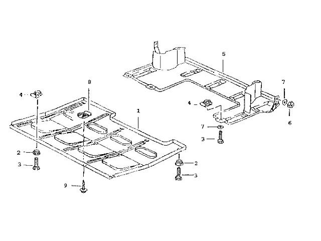

that piece is the first one (the front apron) - it actually has ducts molded into it
then there is a center plastic one that goes about halfway down the oil pan - then there is a third metal one that runs behind that - these are shown here:
Bellypan - Joel968 - 08-28-2009
I believe that the aft metal pan was on early cars only.

<!--quoteo(post=79063:date=Aug 28 2009, 01:15 PM:name=flash)-->QUOTE (flash @ Aug 28 2009, 01:15 PM) <{POST_SNAPBACK}><!--quotec-->not really rare, but yes, many of them are missing the parts
[Image: attachment.php?thumbnail=6931]<!--QuoteEnd--><!--QuoteEEnd-->
These pieces are still available form Porsche. I just had my front apron and center plastic piece replaced as part of an insurance claim resulting from a collision with a rabbit!
