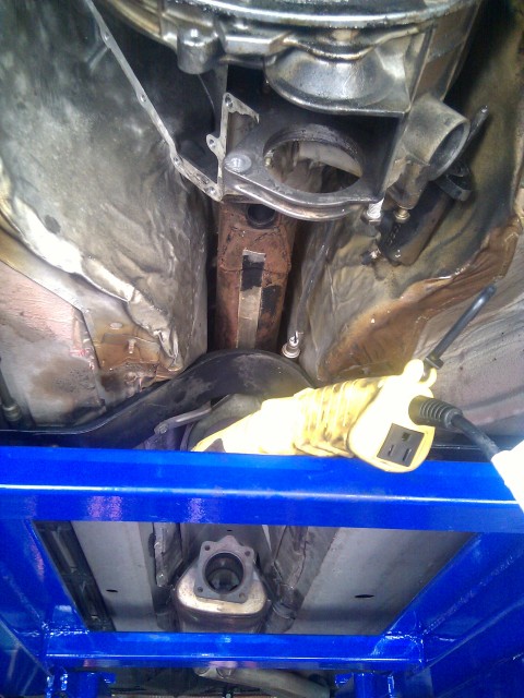

Slit Skirt Jeanie isn't wearing those Slit Skirt-or is she? - tamathumper - 04-19-2012
Here's a photo of mine - it has a "sticker" on it?
[Image: torque_tube.jpg]
Slit Skirt Jeanie isn't wearing those Slit Skirt-or is she? - flash - 04-19-2012
looks like yours has a slit
Slit Skirt Jeanie isn't wearing those Slit Skirt-or is she? - Cloud9...68 - 04-20-2012
Flash,
So sorry, I stand corrected - mine DOES have a slit. It doesn't extend to the back of the TT, which is where I was looking from when I concluded it's slitless, but from the front, you can clearly see it. It has a "sticker" on it, just like Tama's. And I think mine is a late 92 - it's VIN ends in 820386, for those who can correlate that to the car's vintage.
