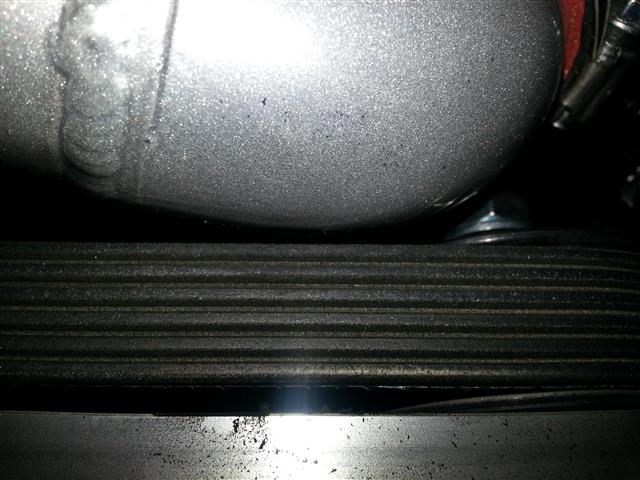

Next test - flash suggested I take off the belt guard and see if it still makes the "ting" noise, so I took off the belt guard and was surprised to find some wear on the underside, indicating that perhaps my belt is too loose? The paint is worn off on the lowest edge, and it has been rubbed by some of the other ribs.
![[Image: belt_guard_wear.jpg]](http://www.allenlook.com/images/forums/belt_guard_wear.jpg)
The belt guard was at a slight angle as indicated in the instructions, and the wear is heavier on one side, also showing it's at an angle. It was also at the top of the screw holes as required. I also found a little bit of wear on the "S" pipe which was a surprise as I had more than the 2mm of clearance there, but maybe the belt was that loose and "slapping". That's one spot I keep a close eye on because of the tight clearance, (and the alternator vanes near the upper radiator pipe is another spot I am just generally nervous about). The angle of the photo shows the clearance, but not the wear - there's a little rice-grain sized part where the powder coat has been rubbed.

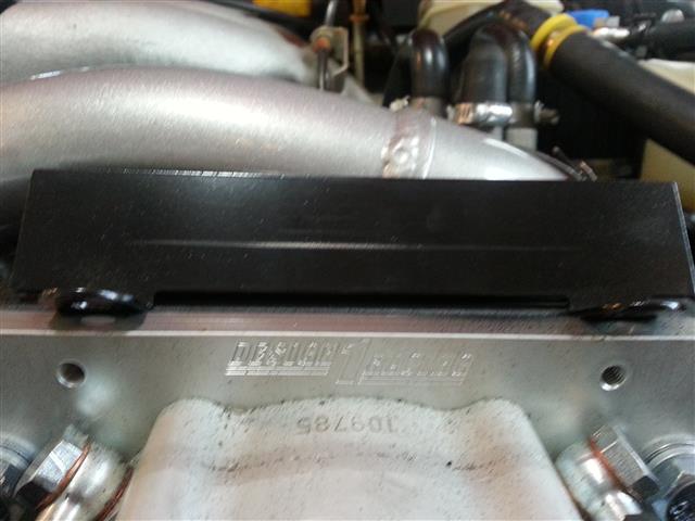

![[Image: s_pipe_wear.jpg]](http://www.allenlook.com/images/forums/s_pipe_wear.jpg)

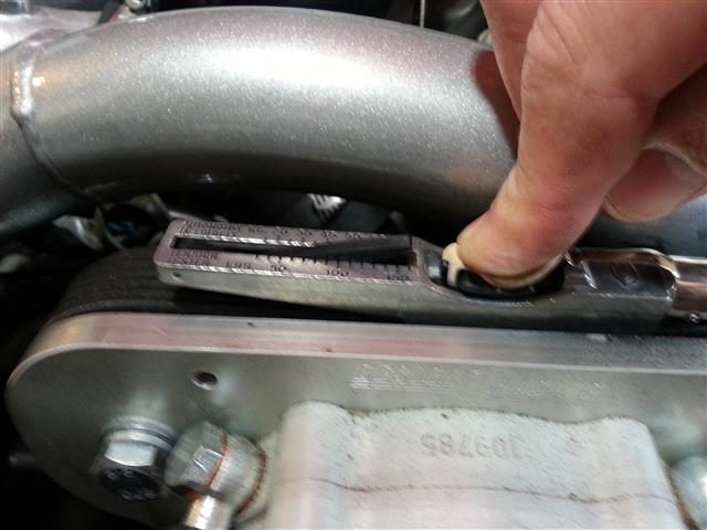

Just for grins, I put the Krikit on the top run of the belt and measured the tension. 30 lbs. on the dot.

So, (and this is important for the next paragraph), because of the wear, I loosened the silicone bell and pushed the "S" hose a little further onto the throttle body and away from the belt. I verified it wasn't interfering with the swing of the throttle plate by working the throttle back and forth by hand. Then I started the car and it ran fine for several minutes. There was no "ting" sound.
After a few minutes, the idle dropped very low and I thought the car was going to stall out. It has never done that before when just sitting idling. It recovered after about 5 seconds, but the check engine light had come on. I did a "blink test" and got a 1-2-1-6 (Throttle Potentiometer). This is new - never seen it before - and I wonder if pushing the "S" pipe further onto the throttle body could interfere with it in some way? I restarted the car and it smelled very, very rich. I turned off the car and verified the "S" pipe doesn't interfere with the throttle, at least not visually, although it is close to touching the throttle's return coil spring.
I shut everything down and came inside to post this and pack for Vegas. I welcome your constructive comments. <img src="/forum/images/smilies/968/wink.png" class="smilie" alt="" />

moving in inward won't mess with the throttle pot. are you sure the connector is fully seated?
make a small notch in the adaptor hose to clear the spring if you need to.
make sure your clamps are tight with no gaps. use a nutdriver not a screwdriver. it's pretty easy to get a leak at the corner of the charge pipe if that clamp is sitting just right. that will cause things to get wonky.

OK, I'll double-check all the fittings, including the electrical connector. I'll give it a squirt of electronics cleaner for good measure.
The little silicone bell hose is already notched, but I'll double-check and notch it some more if it calls for it. It's possible I loosened the hose clamp on the throttle body and didn't re-tighten it. <img src="/forum/images/smilies/968/blink.png" class="smilie" alt="" />

I tensioned the belt to 70 lbs. (measured with Krikit on the lower span, just above the tensioner). Upon test drive, noise is now gone, only the "whistle" remains. <img src="/forum/images/smilies/968/smile.png" class="smilie" alt="" />

After a couple thousand miles, I re-checked the belt tension again yesterday. It is down from 70 to 50 pounds as measured with the Krikit and the first groove of wear has begun to show again on the belt guard.
I know there isn't a spec for the belt tension, but can anyone pop a Krikit (or some other method) on yours and tell me how tight your SC belt is? I might be overly cautious and keeping it too loose?
07-05-2013, 10:30 AM
increase the angle of the tabs on the belt guard, drill out the holes a bit bigger, and pull it upward as much as you can.
