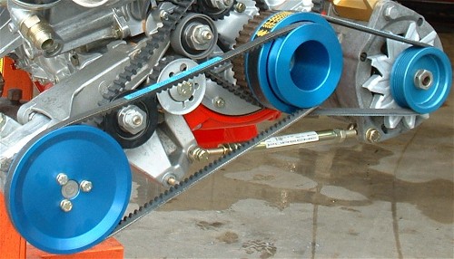

looking at this image
[Image: crankpulleyL.jpg]
no belts will haft to be altered, but here the question
Does the current pump mount against the engine, or are there internal connections that im going to need to deal with, from this picture it does not look like it

Replacing the existing pump with an electric one is pretty much impossible. The pump pulley is driven by the timing belt and re-engineering this setup would require a major revision to the entire front of the motor. Your picture of the belts crops out the actual pump and pulley.

[quote name='Greimann' date='Apr 13 2005, 10:21 PM']Replacing the existing pump with an electric one is pretty much impossible. The pump pulley is driven by the timing belt and re-engineering this setup would require a major revision to the entire front of the motor. Your picture of the belts crops out the actual pump and pulley.
[right][post="3223"]<{POST_SNAPBACK}>[/post][/right][/quote]
i did not see that, but it increases the difficulty more than I anticipated...
i could gut the current waterpump and leave just the pulley assembly, that would keep the timing belt properly set, but i have to see how its pulley is connected to the turbine, this might introduce other problems, anyone got a old pump they wanna pull apart and take picture of the internals?
